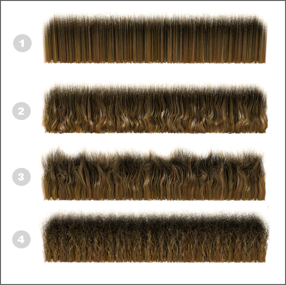

Kink displacement works similarly to Frizz, but evaluates noise lookups along the whole length of the guide. The result is a noise pattern that works on a larger scale than the Frizz noise. The effect is similar to crimped hair.
1. All settings=0.0 (no kink)
2. Kink Root=0.5 (rest=0.0)
3. Kink Tip=10.0, Kink Root=0.0, Kink X/Y/Z Freq=4.0
4. Kink Tip=10.0, Kink Root=0.0, Kink X/Y/Z Freq=50.0

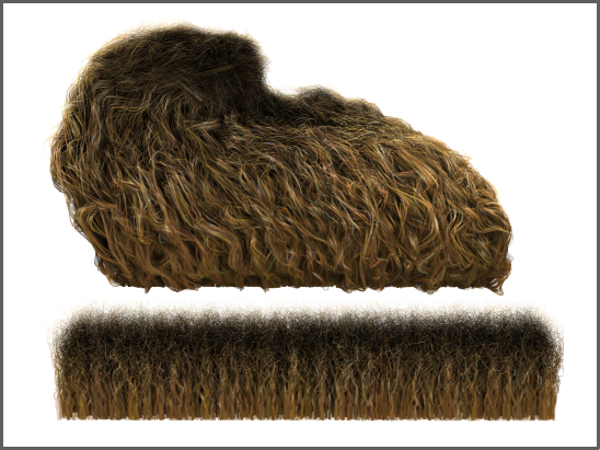

Kink Root=0.5, Kink Tip=0.0, Kink X/Y/Z Freq=4.0
Top: Styled
Bottom: Unstyled

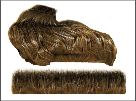

- Kink Tip
Controls the amount of kink displacement of the hair at its tip. Default=0.0. Range=0.0 to 100.0
Top: Styled, Kink Tip=10.0, Kink Root=0.5, Kink X/Y/Z Freq=50.0
Bottom: Unstyled, Kink Tip=10.0, Kink Root=0.0, Kink X/Y/Z Freq=50.0
