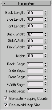

Parameters rollout
- Back/Side/Front Length
Specify the length of each of the three sides.
- Back/Side/Front Width
Specify the width of each of the three sides.
- Height
Specifies the overall height of the object.
- Back/Side/Front Segs
Specify the number of segments for a specific side of the object.
Note: The object's dimensions (Back, Side, Front) are labeled as though it were created in the Top or Perspective viewports, and seen from the front in world space. - Width/Height Segs
Set these to specify the number of segments for the overall width and height of the object.
- Generate Mapping Coords
Sets up the required coordinates for applying mapped materials to the object. Default=on.
- Real-World Map Size
Controls the scaling method used for texture mapped materials that are applied to the object. The scaling values are controlled by the Use Real-World Scale settings found in the applied material's Coordinates rollout. Default=off.
