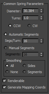

Common Spring Parameters group
- Diameter
The overall diameter of the spring, as measured at the center of the wire. (The diameter of the wire itself has no effect on this setting.)
- Turns
The number of full 360-degree turns in the spring.
- CCW/CW
Specifies whether the coils of the spring are counterclockwise (CCW) or clockwise (CW).
- Automatic Segments
Choose this option to force each turn of the spring to contains the same number of segments, as specified in the Segs/Turn spinner. Thus, if you increase the number of turns, the number of segments also increases.
- Segs/Turn
This spinner lets you specify the number of segments in each 360-degree turn of the spring.
- Manual Segments
When this option is chosen, the length of the spring contains a fixed number of segments, no matter how many turns in the spring. Thus, as you increase the number of turns, you must manually increase the number of segments to maintain a smooth curve.
- Segments
This spinner lets you specify the total number of manual segments in the spring.
- Smoothing
Provides various methods of smoothing the object. The options here work the same as those in the Torus primitive.
- All All surfaces are smoothed.
- Sides Smoothing runs along the length of the wire, but not around its perimeter.
- Segments Smoothing runs around the perimeter of the wire, but not along its length.
- None No smoothing is applied.
- Renderable
When on, the object appears in the rendering; when off, the object does not appear.
- Generate Mapping Coords
Assigns mapping coordinates to the object. Default=on.

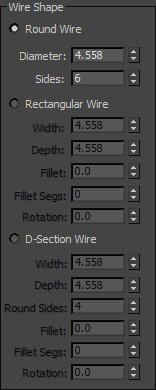

Wire Shape group
Provides three different types of wire cross-sections for the spring: round, rectangular, or D-shaped. Each type has its own set of parameters.
- Round Wire
Specifies a round wire for the spring.
- Diameter The diameter of the wire.
- Sides The number of sides that make up the cross section.
- Rectangular Wire
Specifies a rectangular wire.
- Width Determines the width of the cross section.
- Depth Determines the depth of the cross section.
- Fillet When combined with Fillet Segs (below), this lets you fillet (round) the corners of the cross section.
- Fillet Segs Specifies the number of segments in the fillet.
- Rotation Rotates the angle of the cross section along the entire length of the spring.
- D-Section Wire
Specifies a D-shaped wire.
- Round Sides Specifies the number of segments that make up the rounded side of the D-shape.
