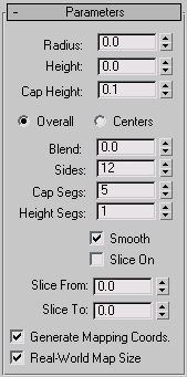

Parameters rollout
- Radius
Sets the radius of the spindle.
- Height
Sets the dimension along the central axis. Negative values create the spindle below the construction plane.
- Cap Height
Sets the height of the conical caps. The minimum value is 0.1; the maximum value is ½ the absolute value of the Height setting.
- Overall/Centers
Determines what the Height value specifies. Overall specifies the overall height of the object. Centers specifies the height of the midsection of the cylinder, not including its conical caps.
- Blend
When greater than 0, creates a fillet where the caps meet the body of the spindle.
- Sides
Sets the number of sides around the spindle. Higher numbers shade and render as true circles with Smooth on. Lower numbers create regular polygonal objects with Smooth off.
- Cap Segs
Sets the number of concentric divisions along the center of the spindle's top and bottom.
- Height Segs
Sets the number of divisions along the spindle's major axis.
- Smooth
Blends the faces of the spindle, creating a smooth appearance in rendered views.
- Slice On
Turns on the Slice function. Default=off.
When you create a slice and then turn off Slice On, the complete spindle reappears. You can therefore use this checkbox to switch between the two topologies.
- Slice From, Slice To
Sets the number of degrees around the local Z axis from a zero point at the local X axis.
For both settings, positive values move the end of the slice counterclockwise; negative values move it clockwise. Either setting can be made first. When the ends meet, the whole spindle reappears.
- Generate Mapping Coords
Sets up the required coordinates for applying mapped materials to the spindle. Default=on.
- Real-World Map Size
Controls the scaling method used for texture mapped materials that are applied to the object. The scaling values are controlled by the Use Real-World Scale settings found in the applied material's Coordinates rollout. Default=off.
