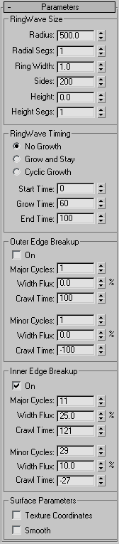

Interface
RingWave Size group
Use these settings to change the ringwave's basic parameters.
- Radius
Sets the outside radius of the ringwave.
- Radial Segs
Sets the segment count between the inner and outer surfaces in the direction of the radius.
- Ring Width
Sets the mean ring width as measured inward from the outer radius.
- Sides
Sets the number of segments in the circumferential direction for both the inner, outer, and end (cap) surfaces.
- Height
Sets the height of the ringwave along its major axis.
Tip: If you leave the Height at 0 for an effect like a shock wave, you will want to apply a two-sided material so that the ring can be seen from both sides. - Height Segs
Sets the number of segments in the direction of the height.
RingWave Timing group
Use these settings for ringwave animation where the ringwave grows from nothing to its full size.
- No Growth
Sets a static ringwave, which appears at Start Time and disappears after End Time.
- Grow and Stay
Animates a single growth cycle. The ringwave begins growing at the Start Time and reaches its full size at Start Time plus Grow Time.
- Cyclic Growth
The ringwave grows repeatedly from the Start Time to Start Time plus Grow Time.
For example, if you set Start Time to 0 and Grow Time to 25, leaving End Time at the default value of 100, and choose Cyclic Growth, the ringwave grows from nothing to its full size four times over the course of the animation.
- Start Time
The frame number where the ringwave appears, and begins to grow if you choose Grow and Stay or Cyclic Growth.
- Grow Time
The number of frames after Start Time the ringwave takes to reach full size. Grow Time is available only if Grow and Stay or Cyclic Growth is chosen.
- End Time
The frame number after which the ringwave disappears.
Outer Edge Breakup group
Use these settings to change the shape of the ringwave's outer edge.
- On
Turns on breakup of the outer edge. The remaining parameters in this group are active only when this is on. Default=off.
- Major Cycles
Sets the number of major waves around the outer edge.
- Width Flux
Sets the size of the major waves, expressed as a percentage of the unmodulated width.
- Crawl Time
Sets the number of frames each major wave takes to move around the outer circumference of the RingWave.
- Minor Cycles
Sets the number of random-sized smaller waves in each major cycle.
- Width Flux
Sets the average size of the smaller waves, expressed as a percentage of the unmodulated width.
- Crawl Time
Sets the number of frames each minor wave takes to move across its respective major wave.
Inner Edge Breakup group
Use these settings to change the shape of the ringwave's inner edge.
- On
Turns on the breakup of the inner edge. The remaining parameters in this group are active only when this is on. Default=on.
- Major Cycles
Sets the number of major waves around the inner edge.
- Width Flux
- Crawl Time
Sets the number of frames each major wave takes to move around the inner circumference of the RingWave.
- Minor Cycles
- Width Flux
- Crawl Time
Note: Negative values in the Crawl Time parameters change the direction of the wave. To produce interference patterns, use Crawl Time settings of opposite sign for major and minor waves, but similar Width Flux and Cycles settings.Tip: To produce the best "random" results, use prime numbers for major and minor cycles that differ by a multiple of two to four. For example, a major wave of 11 or 17 cycles using a width flux of 50 combined with a minor wave of 23 or 31 cycles with a width flux of 10 to 20 makes a nice random-appearing edge.
Surface Parameters group
- Texture Coordinates
Sets up the required coordinates for applying mapped materials to the object. Default=on.
- Smooth
Applies smoothing to the object by setting all polygons to smoothing group 1. Default=on.
