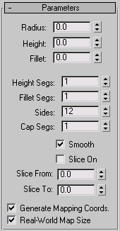

Parameters rollout
Radius
Sets the radius of the chamfered cylinder.
Height
Sets the dimension along the central axis. Negative values create the chamfered cylinder below the construction plane.
Fillet
Chamfers the top and bottom cap edges of the chamfered cylinder. Higher numbers result in a more refined fillet along the cap edge.
Height Segs
Sets the number of divisions along the corresponding axis.
Fillet Segs
Sets the number of segments in the filleted edges of the cylinder. Adding fillet segments curves the edges, producing a filleted cylinder.
Sides
Sets the number of sides around the chamfered cylinder. Higher numbers shade and render as true circles with Smooth on. Lower numbers create regular polygonal objects with Smooth off.
Cap Segs
Sets the number of concentric divisions along the center of the chamfered cylinder's top and bottom
Smooth
Blends the faces of the chamfered cylinder, creating a smooth appearance in rendered views.
Slice On
Enables the Slice function. Default=off.
When you create a slice and then turn off Slice On, the complete chamfered cylinder reappears. You can use this checkbox to switch between the two topologies.
Slice From, Slice To
Sets the number of degrees around the local Z axis from a zero point at the local X axis.
For both settings, positive values move the end of the slice counterclockwise; negative values move it clockwise. Either setting can be made first. When the ends meet, the whole chamfered cylinder reappears.
Generate Mapping Coords
Generates coordinates for applying mapped materials to the chamfered cylinder. Default=on.
Real-World Map Size
Controls the scaling method used for texture mapped materials that are applied to the object. The scaling values are controlled by the Use Real-World Scale settings found in the applied material's Coordinates rollout. Default=off.
