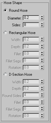

Hose Shape group
Sets the shape of the hose cross section. Default=Round Hose.
Round Hose
Sets a circular cross section.
  • Diameter The maximum width of the hose at the ends.
  • Sides The number of sides of the hose. A Sides setting of 3 gives a triangular cross section; 4 gives a square cross section; and 5 gives a pentagonal cross section. Increase Sides for a circular cross section. Default=8.
Rectangular Hose
Lets you specify different settings for width and depth.
  • Width The width of the hose.
  • Depth The height of the hose.
  • Fillet The amount by which the cross-section corners are rounded. For this to be visible, Fillet Segs must be set to 1 or higher. Default=0.
  • Fillet Segs The number of segments across each filleted corner. A Fillet Segs setting of 1 cuts the corner straight across; use higher settings for rounded corners. Default=0.
  • Rotation The orientation of the hose along its long axis. Default=0.
D-Section Hose
Similar to Rectangular Hose, but rounds one side for a D-shaped cross-section.
  • Round Sides The number of segments on the rounded side. Increase for a smoother profile. Default=4.
  • Fillet The amount by which the two cross-section corners opposite the rounded side are rounded. For this to be visible, Fillet Segs must be set to 1 or higher. Default=0.
