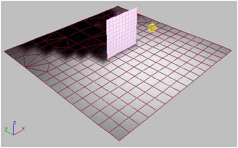

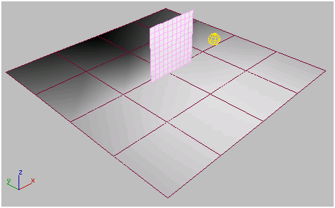

Meshing (shown in light red) subdivides flat surfaces in the scene.

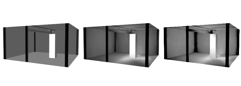

Left: No mesh. The solution looks very flat.
Middle: Coarse mesh, every 24 inches. The lighting improves.
Right: Fine mesh, every 4 inches. The lighting reveals more subtle effects.

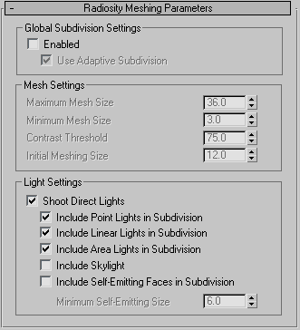

Global Subdivision Settings group
- Enabled
- Turns on the radiosity mesh for the entire scene. Turn off the mesh when you want to perform quick tests.
- Use Adaptive Subdivision Turns adaptive subdivision on and off. Default=on. Note: The Mesh Settings group parameters Minimum Mesh Size, Contrast Threshold, and Initial Meshing Size are available only when Use Adaptive Subdivision is on.

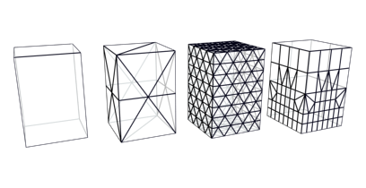

Left: A simple box with no subdivision
.Middle Left: The box faces are subdivided
Middle Right: The box faces are subdivided with a smaller Meshing Size
Right: The box faces are subdivided with Adaptive Subdivision

Mesh Settings group

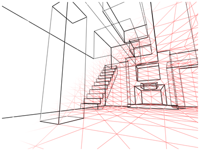

Adaptive Subdivision using the default mesh and light settings

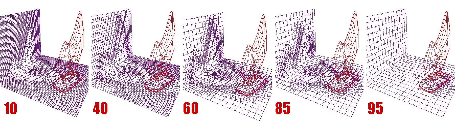

- Contrast Threshold
- Faces that have vertex illuminations that differ by more than the Contrast Threshold settings are subdivided. Default=75.0.
Radiosity solutions with different Contrast Threshold values. The best solution is at the center, with Contrast Threshold=60.

Light Settings group
- Shoot Direct Lights
- When adaptive subdivision or shoot direct lights is on, the direct lighting on all of the objects in the scene is calculated analytically, based on the following switches. Lighting is analytically computed without modifying the object's mesh which produces lighting that is less noisy and more pleasing to the eye. This switch is implicitly enabled when using adaptive subdivision since it is a requirement. Default=on.
