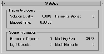

This rollout lists information about the radiosity processing.
Interface
Radiosity process group
Lists the current level of quality and number of refine iterations in the radiosity process.
- Solution Quality
- The current level of quality in the radiosity process.
- Refine Iterations
- The number of refine iterations in the radiosity process.
- Elapsed Time
- The time spent processing the solution since the last reset.
Scene Information group
Lists information on the radiosity processing of the scene.
- Geometric Objects
- Lists the number of objects processed.
- Light Object
- Lists the number of light objects processed. Note: Self-illuminated objects count as one light per face.
- Meshing Size
- Lists the size of radiosity mesh elements in world units.
- Mesh Elements
- Lists the number of elements in the mesh processed. Note: Transparent, 2–sided, and translucent objects' faces are counted twice.
