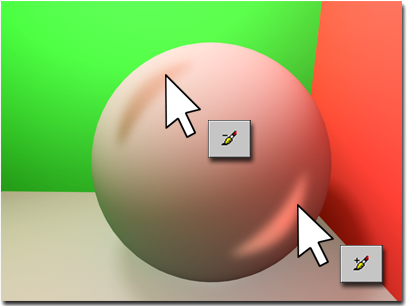

The light painting tools in this rollout allow you to touch up shadowed and illuminated areas manually. You can use these tools to touch up shadow and light-leak artifacts without having to do additional remodeling or radiosity processing. Using Pick Illumination, Add Illumination, and Remove Illumination, you can add or remove illumination on one selection set at a time.
To use the light painting tools, you first select objects, and then choose a light painting tool: Pick Illumination, Add Illumination, or Remove Illumination. 3ds Max highlights the active button, and when the cursor is over a selected object, it changes to a crayon icon for the Add and Remove Illumination tools, or to an eyedropper icon for Pick Illumination.
You can pick, add, or remove illumination through objects. For example, if you select the floor as an object, you can work under the bookshelf, by working through it. Once in light painting mode, you can’t select another object unless you cancel the operation.

Add Illumination -
Adds illumination starting at the vertex of a selected object. 3ds Max adds illumination based on the amount in the Pressure spinner. The pressure amount corresponds to a percentage of the sampled energy. For example, if a wall has about 2,000 lux on it, Add Illumination adds 200 lux to the surface of the selected object.
Remove Illumination -
Removes illumination starting at the vertex of a selected object. 3ds Max removes illumination based on the amount in the Pressure spinner. The pressure amount corresponds to a percentage of the sampled energy. For example, if a wall has about 2,000 lux on it, Remove Illumination removes 200 lux from the surface of the selected object.

Using light painting to add or remove light in a radiosity solution.
