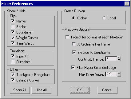

The mixdown options on the Mixer Preferences dialog can help correct these problems. To access this dialog, click Preferences on the Motion Mixer toolbar.
To have an effect on a mixdown, these options must be set before the mixdown is computed. If Prompt for options at each Mixdown is turned on, you will be prompted to set these options each time you compute a mixdown. Otherwise, the mixdown uses the settings on the Mixer Preferences dialog.
The options in the Mixdown Options group determine if and how the mixdown affects transitions between clips with planted feet. Enforce IK Constraints affects planted feet, while Filter Hyper-Extended Legs affects unnaturally straight legs. Turn on Prompt for options at each Mixdown if you want to be asked for these settings each time you do a mixdown. For more information on these options, see Mixer Preferences Dialog.
