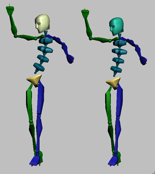

When you use different motions on the upper and lower parts of the biped, you can create a situation where the balance in the two clips do not match one another. For example, if the arms are waving wildly in the motion used for the upper body, the hip motion should compensate to some degree to keep the biped in balance. A straight mix of this arm motion with another hip/leg motion will most likely not match up in terms of balance.
Bipeds with same set of upper and lower body motions. Biped on the left has balance compensation, biped on the right does not.
By default, the Mixer compensates for differences in upper and lower body motion by making slight alterations to the spine and pelvis motions. If the biped bends over at the waist, for example, the pelvis will be moved to compensate for the weight shift, and the spine rotation will be lessened to help the biped keep its balance. Balance compensation is intended to make the biped's motion look as natural as possible.

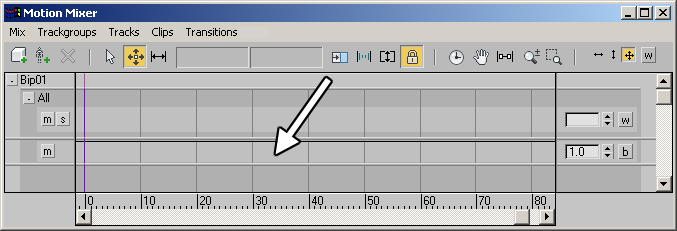

In the Mixer, you can control the degree of automatic balance compensation using the balance track. One balance track is automatically created for each biped as it is added to the Mixer.
Balance track
The balance track has a weight curve for adjusting the degree of automatic balance compensation between upper and lower body trackgroups. By default, the weight value of 1.0 across the balance track provides the maximum degree of compensation. You can reduce the weight curve at various points to lessen the degree of automatic balancing performed by the Mixer.

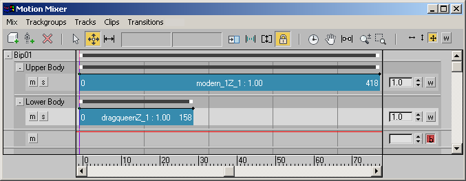

- Add a biped to the Mixer, and create at least two trackgroups for the biped. See Filtering Mixer Tracks.
- Filter one trackgroup to use motion only from the spine, arms and head. See Filtering Mixer Tracks. This trackgroup will hold the upper body motion.
- Filter a different trackgroup to apply only to the legs, pelvis and COM tracks. This trackgroup will hold the lower body motion.
- Add a clip with a great deal of upper body motion to the upper body track. See Importing Clips to the Mixer.
- Add a clip with very different lower body motion to the lower body track.

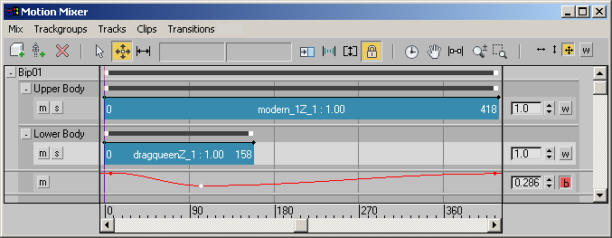

- Click
(Balance Weight Mode). This button is at the far right of the balance track.
The weight curve becomes visible at the top of the balance track.
Tip: If you can't see the weight curve, click Preferences to display the Mixer Preferences dialog, and turn on Weight Curves. - Add nodes to the weight curve, and adjust the nodes. For information on how to add nodes and edit weight curves, see Adjusting Track Weight.
When the weight is set to 0.0, the Mixer will not adjust the spine and pelvis motion to compensate for differences in the upper and lower body motion. Values between 0.0 and 1.0 will adjust the balance to some degree.

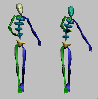

- To adjust the degree of horizontal balance compensation on the pelvis, change the Lateral Ratio parameter. Lower values make more forward/backward motion on the pelvis, while higher values use more side-to-side motion to compensate.
- To adjust the degree to which spine rotation from the lower body motion is propagated on the upper body, change the Propagation parameter. Higher values rotate the spine links to better follow the COM and pelvis motion.
Bipeds with same upper and lower body motion. Biped on left has Propagation set to 0.0, biped on right with Propagation at 1.0.
The values on the Balance Parameters dialog can be used to make subtle adjustments to the biped's balance.
