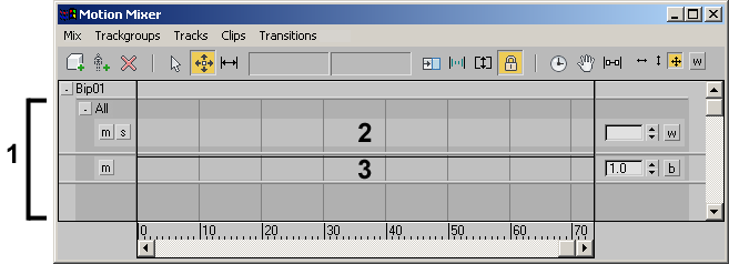

When you open the Mixer while a biped is selected, a trackgroup, a clip track, and a balance track are assigned to that biped. If a non-biped object is selected, the Mixer opens empty.
1. Trackgroup
2. Clip track
3. Balance track
This section discusses clip tracks. To learn about trackgroups, see Filtering Mixer Tracks. For information on the balance track, see Adjusting Track Weight.

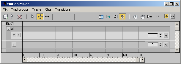

Types of Clip Tracks
There are two types of tracks to which you can add clips:
- Layer
A track for a series of motions that do not need transitions between them. By default, a Layer track is created for a biped when you open the Mixer.

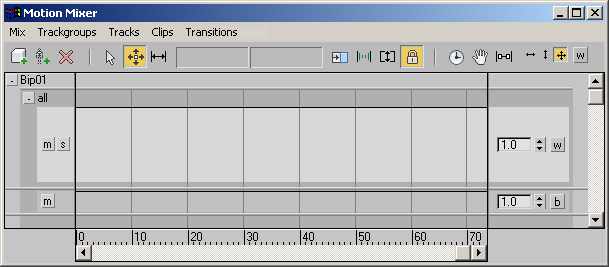

- Transition
A tall track with room for two rows of clips. You can put one motion file on the top tier and another on the bottom, and place a transition in the area where the two clips overlap. Transitions on these tracks are similar to Motion Flow transitions between clips.
Transition track

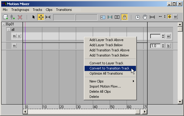

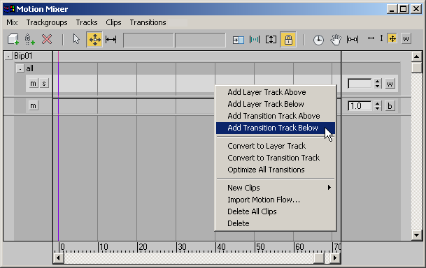

To add a Transition or Layer track to a trackgroup:
- Right-click an existing track and choose one of the options for adding tracks from the pop-up menu.
To convert a clip track from one type to another:
- Right-click an existing track, and choose one of the options from the pop-up menu for converting tracks.
