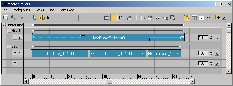

Dashed lines appear on a time-warped clip in the Mixer to indicate the motion speed at different points in the clip.
Time warp added to topmost clip.

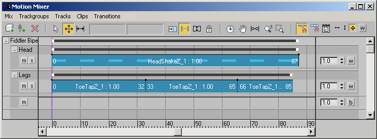

Warping a clip's time requires two steps. First a time warp must be added to the clip with the Clips
Add Time Warp menu option. Then you turn on Editable Time Warps to see the dashed lines and adjust the clip's timing.

A series of evenly spaced dashes appears on the clip. The lengths of the dashes indicate the relative speed of the clip at various points. Right now, all dashes are evenly spaced to indicate the clip is playing at its original speed from beginning to end.

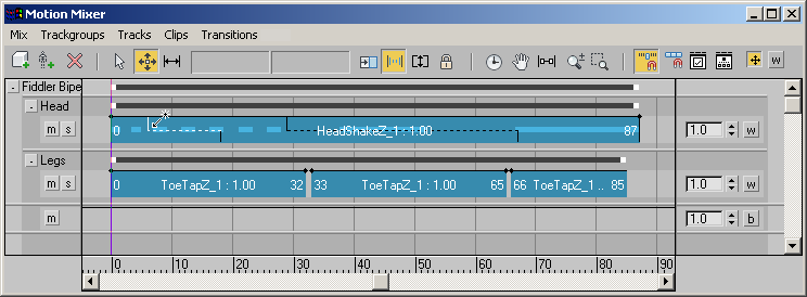

- Move the cursor over the clip's horizontal center line until an arrow cursor appears.
- At the approximate original time, click the clip to set a time warp bar.
A time warp bar actually consists of two parts, a top and a bottom.
- Click the top half the bar. The top half turns white to indicate it is selected.
- Drag the top half of the bar to the left or right to set it to the warped time noted in step 3 of the previous procedure. This will cause the motion at the original time to occur at the warped time. Tip: As you drag the top bar, watch the Frame value at the top of the Motion Mixer window to see the top bar's new frame number.
The lengths of the dashed lines change to indicate the new timing. Where lines are shorter, the motion will play faster. Where lines are longer, the motion will slow down.
- Select and move the bottom bar to change the original time.
Either bar can be moved to change the effect of the time warp. The length of separation between the two bars sets the degree of time-warping that will occur. When both bars are aligned, no warping occurs.

- You can time-warp other parts of the clip by adding more time-warp bars with the arrow cursor, then moving the new top bars. When you add a second time warp bar after editing the first, the top bar appears where you click, but the bottom bar appears in a different location. The bottom bar's location corresponds to the original time of the top bar before the clip was time-warped.
Note: You cannot move one time warp's top bar past another on the clip. - When you have finished warping the clip's time, turn off
(Editable Time Warps). When Editable Time Warps is turned off, the bars and the dashed line between them remain displayed on a clip to indicate it has been time-warped.
