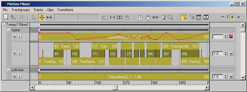

Each track's weight curve appears as a thin black line across the top of the track.
You access the weight curve by clicking the Weight Mode button at the right end of the track. Clicking Weight Mode on the Motion Mixer toolbar enables weight curve editing for all tracks. When Weight mode is on, you can work only with the weight curve, and not with clips.
You edit a weight curve using nodes (points) on the curve. Clips on layer tracks automatically have a node at each end of each clip. A transition track has no nodes by default.

To adjust a weight curve:
- Open the Mixer, add a biped to the Mixer, and create two tracks for a trackgroup. See Filtering Mixer Tracks.
- Place different motion clips on the tracks.
- For the topmost track in the trackgroup, click
(Weight Mode). This button is to the right of the track display.
The weight curve turns red to indicate it can be edited.
You have to do the next two steps only if the weight curve has no nodes, or would like to create more nodes.
- Move the cursor over the line until a small arrow appears. Click to set a node.
- Move the cursor and click to set more nodes on the weight curve.
Tip: On a transition track, you would ordinarily set a node at each end of the track, and at intervals in between. The number of nodes you set depends on the type of curve you want to make. Make as few nodes as possible to get the curve required for your animation.
- Move the cursor over an existing node until a cross cursor appears.
- Click and drag to move the selected node downward.
The Motion Mixer mixes the motions from the topmost track with the track below it on that frame. The motions are mixed to a greater or lesser degree depending on how low you set the weight curve value for the topmost track.
