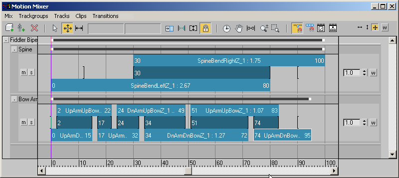

When two or more clips are placed on a transition track, you can create transitions between any two clips. A transition creates a constant, gradual change from one clip to another.
Clips and transitions on Transition track. Transitions are shown as dark areas between clips.
To learn how to create a transition track, see Adding Tracks to the Mixer.

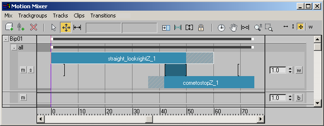

A useful transition can occur anyplace where two clips overlap. The unused part of the clip on either side of the transition appears with hatchmarks to indicate that that part of the clip will not be used in the mix. This type of transition is often used for foot-based clips, when the best place for a transition is not always at the edge of a clip.
Hatched parts of the clips are not used in the mix.

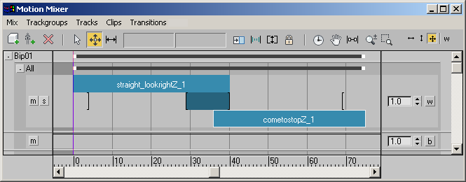

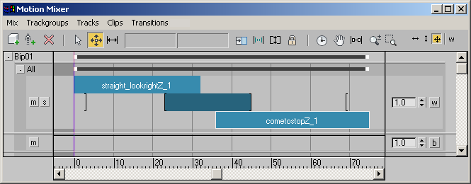

The Motion Mixer will allow you to extend a transition into an area where two clips do not overlap. However, this transition will most likely result in undesirable motion in the mix.
Transitions extending into areas where clips don't overlap can create unpredictable results.
For the best results, make sure all your transitions cover only areas where two clips overlap completely.
