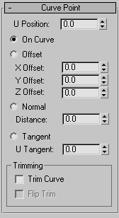

While a curve point sub-object is selected, the Curve Point rollout appears.
U Position
Specifies the point's location on the curve or relative to the curve.
On Curve
When on, the point lies on the curve at the U Position.
Offset
Moves the point according to a relative (object space) X,Y,Z location.
This is relative to the U Position.
X Offset, Y Offset, and Z Offset
Specify the object space location of the offset curve point.
Normal
Moves the point along the direction of the curve's normal at the U Position.
Distance
Specifies the distance along the curve's normal. Negative values move the point opposite to the normal.
Tangent
Moves the point along the tangent at the U Position.
U Tangent
Specifies the distance from the curve along the tangent.

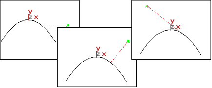

Offset, normal, and tangent displacement of a curve point
Trimming group
Controls in this group let you trim the parent curve.
Trim Curve
When on, trims the parent curve against the curve point's U position. When off (the default), the parent isn't trimmed.
Flip Trim
When on, trims in the opposite direction.

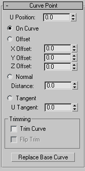

Replace Base Curve
(Only at modification time.) Lets you replace the parent curve. Click the button, then click the new curve on which to base the curve point.
