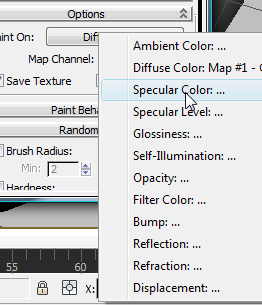

Paint On
Choose a map type in the object’s material to paint on. Click the button to open a list of the available map types:
Choose a map type from the list. For example, to paint the object’s coloring with a Standard material, choose the Diffuse Color map.
If the map type does not have a bitmap image file assigned, choosing the map type opens the Create Texture dialog. Otherwise Viewport Canvas paints on the existing bitmap.
Note: If the assigned map type is not a bitmap, you’re prompted to choose a component of the map, typically a color, for which to create a bitmap. Viewport Canvas requires a bitmap file to work with.
