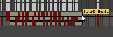

  3. Drag out a time block in the Key window, or use an existing block.
    As you drag the block, two vertical lines and a tooltip show the start and end points. Also, the block appears behind the keys as a solid-color bars behind the keys in each track.
