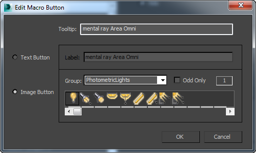

Edit Button Appearance Dialog
Use this dialog to change the appearance of the selected button. You can substitute a different icon for the button, or change to a text button instead. You can also customize the tooltip.
  • Right-click any button on a custom toolbar. > Edit Button Appearance

Interface
Tooltip
You can add your own tooltips to the buttons. The tooltip displays when the mouse is over the tool button. You can edit this text to describe the tool.
  • Text Button Lets you assign text to the button.
    Label Enter the text to appear on the button.
  • Image Button Lets you assign an image (icon) to the button. You can use any predefined icon that you want by selecting it in the controls on the right.
    Group Displays a list of button categories. The groups of icons change with each category selection.
    Odd Only Certain icon sets, including Internal, Classic, Main toolbar, and others, are designed in pairs. In each pair, one icon depicts the button when enabled, and the other shows how it looks when disabled. When Odd Only is on, the interface displays only the odd-numbered icons (enabled), when Odd Only is off, all of the icons, enabled and disabled, are displayed.
    [icon index] Shows the index number of the icon that is currently highlighted in the list below.
    [scrollable icon list] Shows the icons available for the group you choose. To assign an icon to the toolbar button, highlight it in this list, then click OK.
