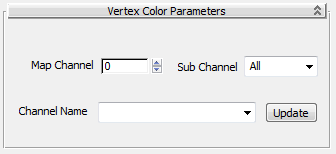

These parameters let you define which map channel or sub-channel is to be rendered. One application is to support usage of the Vertex Color map in conjunction with the Channel Info Utility.
The settings are interlinked; changing one parameter will change the other two, as appropriate.
- Map Channel
Lets you specify which map channel to use. Range=0 to 99. Default=0.
Notes regarding this setting:
- If you set Map Channel to a channel that doesn't contain any vertex coloring data, attempting to render will generate a Missing Map Coordinates error message. To resolve this, apply vertex coloring to that channel.
- By default, the vertex coloring in map channel 1 is a color gradient derived from the UVW texture coordinates by converting UVW values to RGB values. Thus, at UV=0,0 (the lower-left corner of the map), the coloring is black; at UV=1,0, the coloring is red, and at UV=1,1 (the upper-right corner), the coloring is yellow (red + green=yellow). You can change these colors with a tool such as VertexPaint modifier.
- Map Channel cannot be set to a negative value, thus the map doesn't support rendering of the vertex illumination (–1) or vertex alpha (–2) channel.
- Sub Channel
Lets you can specify that the map will use either the Red, Green, or Blue sub-channel of the specified map channel, or all sub-channels.
- Channel Name
After assigning the material with the Vertex Color map to an object with named map or vertex-color channels (see Channel Info Utility), you can click Update, and then, from this drop-down list, choose a named map channel from the object.
- Update
Refreshes the contents of the Channel Name drop-down list. Use Update after applying the material to an object, or after adding channels to the object.
Note: There could be conflicts if one material with a Vertex Color map is assigned to objects with different named Map Channels, where one channel's name may be displayed in preference to another's.
