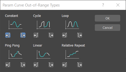

The Parameter Curve Out-of-Range Types dialog gives you four ways to repeat animation and two ways to apply linear values.

- Open the Edit menu, then the Controller submenu, and choose Out Of Range Types.
This opens a dialog that lets you specify how the animation should behave before and after the explicit animation range.
- On the dialog, click the left arrow under the In type (behavior before the animation keys) and the right arrow under the Out type (behavior after the animation keys), then click OK to exit.
For example, you could click the left arrow under Loop and the right arrow under Ping Pong.
The Curve Editor displays the out-of-range behavior with dashed lines.
Note: If the first animation key is at the start of the animation, the In type choice doesn't have any effect.
Play the animation to see the result. Tip: You can create keys from the out-of-range type by using the Track View Utilities
Create Out of Range Keys.

Choose from the options for repeating your animation: Click the left arrow to specify behavior before the animation-key range, and the right arrow to specify behavior after the range.
- Constant
Holds the value of the start or end key of the range for all frames. Use Constant when you want no animated effect before the first key of the range or after the last key. Constant is the default out-of-range type.
- Cycle
Repeats the same animation as within the range. If the first and last keys in the range have different values, the animation will show an abrupt "jump" from the last key to the first. Use Cycle when you want an animation to repeat, but do not need the ends to match.
- Loop
- Repeats the same animation as within the range, but interpolates between the last key and first key in the range to create a smooth loop if the range is extended. When the first and last keys are both at the extreme ends of the range, as is usually the case, Loop behaves exactly like Cycle. If you use Position Ranges to extend the range bar beyond the keys, the added length determines the amount of time used to interpolate between the last key and the first key. Use Loop with an extended range bar to produce smoothly repeating animation.
For specific instructions on how to create interpolation with the Loop option, see this procedure.
- Ping Pong
Alternates between forward and backward repetition of the animation within the range. Use Ping Pong when you want your animation to alternate back and forth.
- Linear
Projects the animation value along a line tangent to the function curve at the end of the range. Use Linear when you want the animation to enter and leave the range at a constant velocity.
- Relative Repeat
Repeats the same animation as within the range but offsets each repetition by the value at the end of the range. Use Relative Repeat to create animations that build on each other as they repeat.
