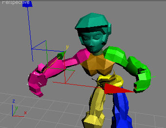

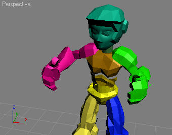

Starting position
The IK target pulled forward
As the right IK target is moved forward the system pulls the ribcage around, maintaining the angle of the arms until it is no longer possible. This is a much more natural movement than stretching out the arm and then rotating the ribcage.

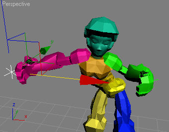

Pulling the IK target out to the side, farther than the arm can reach
As the IK target moves out to the side, the ribcage moves over, trying to keep between the two hands,while still being limited by the length of the spine.

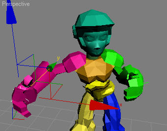

With Allow IK Rotations off, the hub (ribcage) stays straight while still moving as far as it can.
