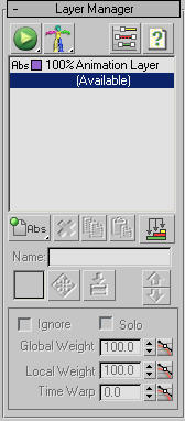

Select any part of the rig. - On the
Motion panel, go to the Layer Manager rollout. In the layers list, highlight the Available item if necessary.
- Click and hold on
(or whichever button is active at the bottom-left of the list) until the flyout opens, and then drag down to
(Add Local Adjustment Layer) and release the mouse button. 3ds Max creates a new layer below the existing layer.
This new layer is active and is weighted to 100%, meaning that you can start tweaking your animation immediately.
Motion panel, go to the Layer Manager rollout. Make sure Available is highlighted in the Layers list.
- Click and hold on
(Add World Adjustment Layer) and release the mouse button. 3ds Max creates a new World Adjustment layer below the existing layer.
This new layer is selected and weighted to 100%, meaning that you can start tweaking your animation immediately.
