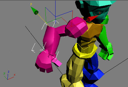

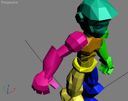

Bending the Elbow
Moving the elbow (forearm) back bends the arm.
Arm position before edit
Arm position after moving forearm

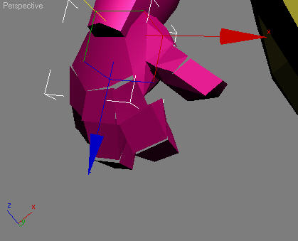

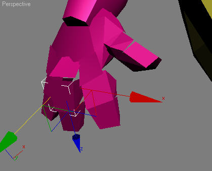

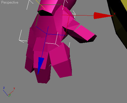

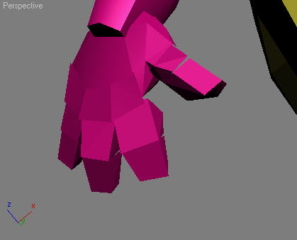

Tweaking the Fingers
Moving finger parts is likewise intuitive.
Outstretched fingers
Moving the middle digit bends up the finger.

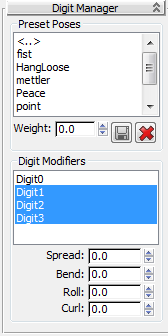

Manipulating Fingers (Digits)
While you can transform fingers (digits) directly, you might prefer to use the Digit Manager instead. Its controls give you the ability to edit selected fingers’ spread, bend, roll, and curl. Digit Manager also has a built-in digit-pose preset manager.
Select the palm.
In the Digit Modifiers list, highlight the digits to edit.
Drag the Curl spinner and the fingers curl in.

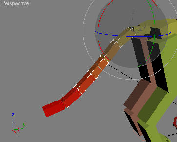

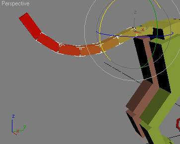

Manipulating the Tail
To manipulate a tail, select several bones in the tail and rotate. All the bones rotate together to cause the tail to curl nicely.
Multiple tail links selected
When rotated up the tail curls smoothly

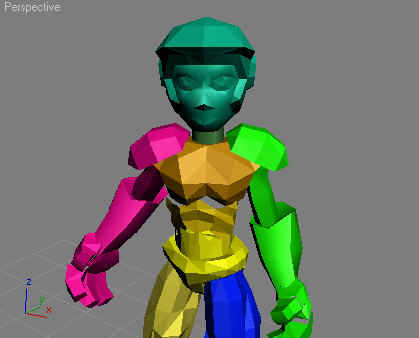

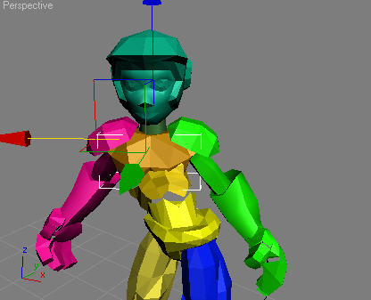

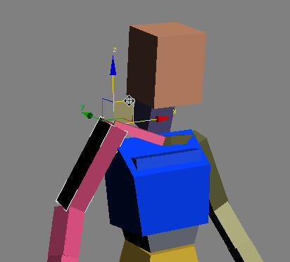

Manipulating Collarbones
Typically, you rotate a collarbone rather than moving it. Also, it’s best not to twist the collarbone.
An easy way to edit the collarbone rotation is to select the upper arm or shoulder bone and move it. When you move the upper arm bone, the collarbone will be rotated according to your movements. Alternatively, select the collarbone directly and use the Move, Rotate, and Scale tools.
