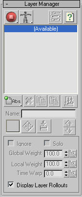

To create an Absolute layer:
  1. Select any part of your CATRig.
  2. On the Motion panel, go to the Layer Manager rollout.
  3. Click and hold on (Abs) so the flyout opens, and then drag down to the second Abs button.
    An Absolute Layer is created in the Layer Manager list.
  4. Above the list, click (Mode) to switch to Animation mode.
You are now ready to start keyframing.
