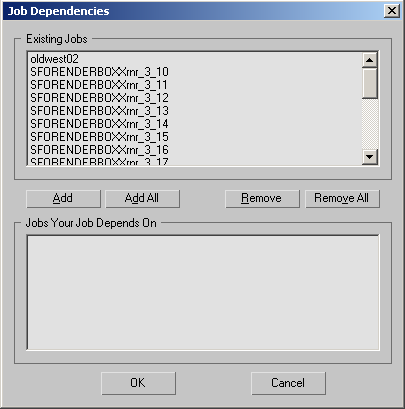

This dialog lets you specify jobs that shouldn't begin rendering until other jobs finish. Use the two lists and the Add and Remove buttons to build a list of jobs that must finish rendering before the current job can start.
Interface
- Existing Jobs list
Lists all previously submitted jobs. To specify a dependency for the current job, add one or more of these to the Jobs Your Job Depends On list.
- Add
Select one or more jobs your job is to depend on, and then click Add to add them to the Jobs Your Job Depends On list.
- Add All
Adds all jobs in the Existing Jobs list to the Jobs Your Job Depends On list.
- Remove
Removes highlighted jobs from the Jobs Your Job Depends On list.
- Remove All
Removes all jobs from the Jobs Your Job Depends On list.
- Jobs Your Job Depends On list
