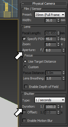

As you develop your scenes in 3ds Max, you will need to experiment with various exposure settings to obtain the right lighting conditions. Some of these settings depend on speed and aperture; in particular, the Physical Camera models physical exposure controls.
(The exposure type of 1 / seconds is not the default choice for Physical Camera, but it is the most common type for old-style still-image film cameras.)
The next three illustrations show the effects different exposure settings can have on an identical scene.
Properly exposed scene: shutter speeed 1/500s at f8.
Underexposed scene: shutter speeed 1/1000s at f16.
Overexposed scene: shutter speed 1/100s at f5.6.
