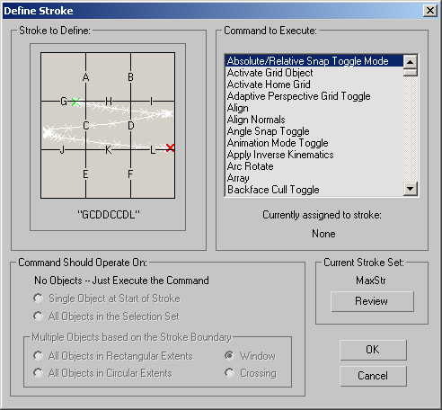

In the Define Stroke dialog, you can see how the strokes are analyzed by examining the grid under Stroke to Define. When you complete the drawing of a stroke, a nine-square grid is centered around the stroke and fit to its extents. The inner segments of the grid are assigned unique letters. Where the stroke crosses a segment, the letter associated with that segment is added to the stroke name. Thus, the direction and the shape of the stroke matter, but the size of the stroke has no effect.
The stroke is always centered within the grid. If you draw a stroke vertically from top to bottom, the stroke is named HK because it crossed the segments labeled H and K, in that order. Had you drawn the stroke from bottom to top, it would have been named KH.

Stroke to Define group
Displays the name of the stroke and displays the stroke you just drew as a series of white Xs connected by white lines. A green X represents the start of the stroke and a red X represents the end. The labeled grid shows you how it recognizes the stroke. Where the stroke crosses the labeled segments in the grid, a letter is added to the name of the stroke.
Command to Execute group
Lists all commands to which you can assign a stroke. Select a command and click OK to assign the stroke displayed in the grid to the selected command. Depending on the type of command you choose in this list, various options become available in the Command Should Operate On group.

Currently assigned to stroke
Displays the name of the stroke currently assigned to the selected command. If you pressed Shift or Alt when the stroke was drawn, they're added to the name. For example: "Shift + HK" or "Alt + HK."
Provides a number of options that specify which objects (if any) are affected by the command. These options are enabled or disabled depending on the type of command you've selected in the list window.
No Objects Just Execute the Command
This text is displayed when you choose a command that's not specific to selected objects, such as Orbit. When you select a command that can be applied to selected objects, the following options become enabled:
  • Single Object at Start of Stroke Causes the command to act on the object beneath the first stroke point in the active viewport.
  • All Objects in the Selection Set Causes the command to act on all objects in the current selection set.
Multiple Objects Based On The Stroke Boundary
Choosing one of the options in this group lets you use the stroke itself to select multiple objects and then apply the command.
  • All Objects in Rectangle Extents Selects all objects defined by the rectangular bounding of the stroke.
  • All Objects in Circular Extents Selects all objects defined by the largest circle that fits within the rectangular bounding of the stroke.
Window/Crossing When you choose either of the previous two options, these two options become available. Window selects only those objects entirely within the rectangular or circular region. Crossing selects all objects within or crossing the region.
Current Stroke Set group
Displays the name of the current stroke set, so you can review the strokes defined in that set. You can create and save a number of different stroke sets. See Stroke Preferences Dialog.
