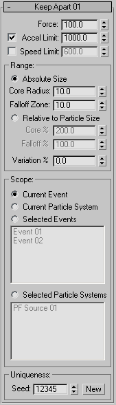

Interface
The user interface appears in the parameters panel, on the right side of the Particle View dialog.
- Force
- The amount of force applied to the particles. Use positive values to separate particles, or negative values to move them closer together. Default=100.0
- Accel[eration] Limit
- When on, lets you set a maximum acceleration value that can be applied to particles' motion. When off, Particle Flow uses any necessary acceleration. Default=on, 1000.0.
Tip: Use a lower Accel Limit value for smooth motion, and a higher value when greater accuracy is needed, such as when the particles should hit a small target. You can animate this setting (use Sync By
Event Duration) to specify different appropriate values, depending on the required results.
- Speed Limit
- When on, lets you set a maximum speed value that can be applied to particles' motion. When off, Particle Flow uses any necessary speed. Default=off, 600.0.
Range group
You can set a volume and falloff within which the force takes effect, either as absolute distances or relative to particle size.
- Absolute Size (The default.) Choose this to set the core radius and falloff zone as absolute distances, in system units.
Core Radius The distance from each particle's pivot point, in system units, within which the force is applied at full strength. Default=10.0
Falloff Zone The distance beyond the core radius, in system units, over which the force diminishes from full strength to 0. Default=10.0
- Relative to Particle Size Choose this to set the core radius and falloff zone as percentages, relative to the radius of each particle. The particle radius is determined by measuring the distance from the pivot point to the farthest corner of its bounding box.
Core % The distance from each particle, as a percentage of the particle radius, within which the force is applied at full strength. Default=200.0
Falloff % The distance beyond the core radius, as a percentage of the radius, over which the force diminishes from full strength to 0. Default=100.0
- Variation %
- The amount by which range values can vary randomly, as a percentage of the specified values. Particle Flow uses the same random variation value for both Core and Falloff values, whether absolute or relative. Default=0.0
For example, if you choose Absolute Size, set Core Radius to 40 and Falloff Zone to 20, and set Variation % to 50, then each particle's actual core radius will be a random number in the range 20 to 60, and the falloff zone a random number in the range 10 to 30. For each particle, Particle Flow uses the same Variation % value, so if Core Radius is determined to be 20, then Falloff Zone would be 10.
Scope group
By default, the Keep Apart force keeps particles only in the current event (that is, the event that contains the Keep Apart operator) apart from each other when used locally, or particles in each event in the current flow apart when used globally. These settings let you alternatively keep particles away from particles in other events or flows without affecting the behavior of latter. Default=Current Event.
- Current Event Keeps particles in the current event only away from each other.
When used globally, keeps particles in each event in the current flow apart from each other, but not apart from particles in other events in the flow.
- Current Particle System Keeps particles in the current event away from each other, and away from all other particles in the current flow. The particles not in the current event are not influenced by the Keep Apart operator.
When used globally, keeps apart and influences all particles in the current flow.
- Selected Events Keeps particles in the current event away from all particles in the events highlighted in the list below this choice. Particles not in the current event are not influenced by the Keep Apart operator.
When used globally, keeps all particles in the current flow apart from all particles in the events highlighted in the list below this choice, but influences only particles in the current flow.
After choosing this option, click items in the list to highlight them.
Selected Particle Systems
Keeps particles in the current event away from all particles in the flows highlighted in the list below this choice. The particles not in the current event are not influenced by the Keep Apart operator.
When used globally, keeps all particles in the current flow apart from all particles in the flows highlighted in the list below this choice, but influences only particles in the current flow.
Uniqueness group
The Uniqueness setting enables randomization of the
Range group
Variation % calculations.
- Seed
- Specifies a randomization value.
- New
- Calculates a new seed using a randomization formula.
