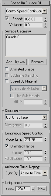

Interface
The user interface appears in the parameters panel, on the right side of the Particle View dialog.
- [speed control drop-down list]
- The first setting lets you choose whether the operator controls speed once or continuously.
- Set Speed Once The operator sets the speed for each particle once: when the particle enters the event.
- Control Speed Continuously The operator sets particle speed throughout the event. When you choose this option, the Continuous Speed Control group becomes available.
- Speed
- The particle speed in system units per second. Default=300.
With the Control Speed Continuously option, you can turn off Speed. This causes Particle Flow to use the current particle speed.
Using a negative Speed value causes particles to move in the opposite direction of that effected by a positive speed.

Surface Geometry group
Use these controls to assign objects to affect particle speed and direction.
- [geometry list]
- The list in this group shows the objects, or reference geometry, that the operator uses to control speed and direction.
If you don't assign any objects, the current particle speed and direction are not affected.
You can assign multiple Surface Geometry objects, but if they're not all emitters as well, the results can be difficult to interpret. In general, assign the same objects as Surface Geometry that your system uses as emitters.
Tip: For optimal performance, when moving particles with respect to high-polygon objects, create a low-poly proxy version to use as surface geometry, link it as a child of the high-poly object if necessary, and then hide the low-poly proxy.
Use the Add and Remove buttons to edit this list.

Direction group
- [Direction drop-down list]
- The Direction drop-down list lets you specify which way the particles go after they're born. In most cases, the actual direction also depends on the icon orientation. The primary exception is when Position
Location is set to Pivot. Particle movement is always in a straight line unless influenced by other factors.
- Surface Normals (The default.) Each particle moves along a line perpendicular to the nearest face. The direction the surface faces doesn't matter.
- Out Of Surface Particles move away from the closest face. Tip: You can use this option to confine particles to the interior of an object. Position the emitter inside the object, designate the object as the Surface Geometry, choose Control Speed Continuously, and choose Out Of Surface. Each time a particle comes close to a surface, it turns to travel directly away from the surface. Control the particles' travel range with the Speed setting, but keep in mind that particles moving very fast might “escape” their container. If this happens, increase the Accel Limit setting; this lets the particles turn more quickly.
- Parallel To Surface Each particle travels parallel to the nearest face.
To make particles orbit an object, use this with Control Speed Continuously, and set appropriate Continuous Speed Control values (see the following section).
When you choose the Control Speed Continuously option, these controls become available. Basically, these controls let the particles move about within the region of the Surface Geometry object rather than in a straight line away from the emitter.
- Accel Limit
- Sets the maximum acceleration. The higher this value, the more quickly particles can turn and change speed. Tip: Use a lower Accel Limit value for smooth motion, and a higher value when greater accuracy is needed, such as when the particles should hit a small target. You can animate this setting (use Sync By
Event Duration) to specify different appropriate values, depending on the required results. - Unlimited Range
