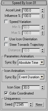

Interface
The user interface appears in the parameters panel, on the right side of the Particle View dialog. When the icon is selected, the parameters also appear on the Modify panel.
- Accel[eration] Limit
- The maximum amount, in system units per second per second, by which the particles' speed can change in order to match the speed of the operator icon. Default=100.0.
If the operator icon changes speed or direction rapidly, increase this value to let the particles follow it more closely.
Tip: Use a lower Accel Limit value for smooth motion, and a higher value when greater accuracy is needed, such as when the particles should hit a small target. You can animate this setting (use Sync By
Event Duration) to specify different appropriate values, depending on the required results. - Influence %
- Determines the mix of the previous speed with the speed of the operator icon. Default=100.0. Range=0.0 to 100.0.
At the default value of 100, the speed is controlled only by that of the icon. At 0, the icon speed doesn't affect particle speed at all. At in-between values, the mix proportion is determined by the Influence % value.
- Speed Variation
- Enables random variation of the particles' speed, so they don't all move at exactly the same rate as the icon. Turn this on, and then set the minimum and maximum percentages of variation. Default=off.
Using Speed Variation can help keep the particles from bunching up as they travel along the animation path. Note, however, that each individual particle's speed doesn't vary; it travels at a constant speed.
Min %/Max % Set the minimum and maximum percentages, respectively, of particle speed variation. Default=50.0 (Min %), 100.0 (Max %).
For example, if you set Min % to 50 and Max % to 200, the particles will vary in speed between half and two times the speed of the icon.
- Use Icon Orientation
- Applies animation of the icon's orientation to the particles.
By default, Speed By Icon controls particle motion only by animation of the icon's position. If you turn on Use Icon Orientation, Particle Flow also applies rotation of the icon to the particle motion. In essence, this motion is circular, and its extent depends on the distance between each particle and the icon. Default=off.
The best way to understand how this works is by using it. To try out Use Icon Orientation, see this procedure.
- Steer Towards Trajectory
- Particles farther away than the Distance value from the icon are moved directly toward the icon. Default=off.
Distance Sets the distance between the particles and the operator icon beyond which Steer Towards Trajectory takes effect. Default=10.0.
Parameters Animation group
If you animate the operator settings, Particle Flow can begin applying this animation to all particles as of the start frame of the animation or the first frame of the current event, or to each particle based on its age. For instance, if you set Sync By to Particle Age, and set Speed Variation keys at frames 0 and 30, then Particle Flow will animate the speed variation for each particle born while the event is active between its birth and its 30th frame of existence. Alternatively, if you set Sync By to Absolute Time, the speed variation is animated from frame 0 to frame 30 of the animation, even if no particles are in the event at that time. Or, if you set Sync By to Event Duration, the speed variation animation is applied to each particle as of the time that it enters the event. For further information, see Animation Offset Keying group.
- Sync By
- Choose the time frame for applying animated parameters:
- Absolute Time Any keys set for parameters are applied at the actual frames for which they're set.
- Particle Age Any keys set for parameters are applied at the corresponding frames of each particle's existence.
- Event Duration Any keys set for parameters are applied to each particle relative to the frame at which it first enters the event.
Icon Animation group
Particle Flow can begin applying animation of the Speed By Icon operator icon to all particles as of the start frame of the animation or the first frame of the current event, or to each particle based on its age. For an explanation, see Animation Offset Keying group.
- Sync By
Choose the time frame for applying animation of the icon to the particles:
- Absolute Time Any keys set for icon motion are applied at the actual frames for which they're set.
- Particle Age Any keys set for icon motion are applied at the corresponding frames of each particle's existence.
- Event Duration Any keys set for icon motion are applied to each particle relative to the frame at which it first enters the event.
- Icon Size
- Sets the size of the operator icon. This setting is for visibility only; it doesn't affect particle behavior.
- Color Coordinated
- When on, the color of the 3D icon is synchronized with the Display operator in the current event. When off, the icon has a standard Particle Flow operator color (blue).
Uniqueness group
The Uniqueness setting enables randomization of the speed variation range.
- Seed
- Specifies a randomization value.
- New
- Calculates a new seed using a randomization formula.
