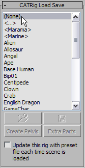

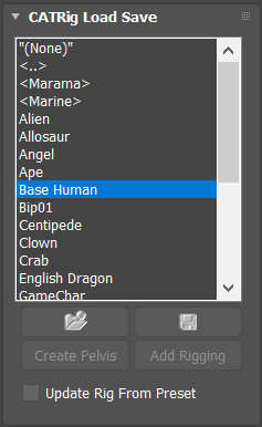

- Choose a preset rig from the list on the CATRig Load Save rollout.

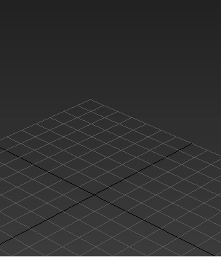

- Click or drag in the viewport to add the preset to the scene.
Note: Preset rigs that use the RG3 format can be added to the scene only by clicking. You can resize the rig subsequently by changing the CAT Units Scale value.
The rig appears in the viewport.
Base Human CATRig preset

- In the list on the CATRig Load Save rollout, make sure <None> is highlighted, and then drag in the Perspective or Top viewport to add the CATParent object.
- With the CATParent selected go to the Modify Panel.
- At the bottom of the CATRig Load Save rollout, click Create Pelvis.
The pelvis appears in the viewport, centered over the CATParent.
