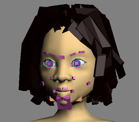

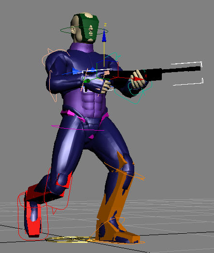

Exta bones are bones you can add to any bone in CAT for any reason. You can use extra bones for armor, breathing and facial animation, weapons, walking sticks, and so on.
