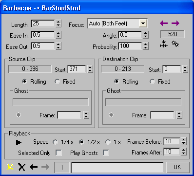

Editing Transitions Manually (Ghosts)
Manually setting the Start Frame for the source and destination clips offers the most control. Unwanted motion in either clip can be avoided and judging the best Start Frames for both clips is left to you.
The Ghost area Frame spinners allow you to view and scrub the source and destination clips by displaying stick figures (ghosts); yellow and red stick figures represent the source and destination clips. When a suitable Start Frame is located for both clips, use Set Start Frame in the Ghost area to copy the Frame values to the Start Frame fields in the Source and Destination Clip areas.
Scrubbing the time slider over the transition period enables you to view the biped's transition from the yellow stick figure (source) to the red stick figure (destination).

Interface
- Length
- Sets the number of frames for the duration of the transition.
Transitions are calculated by matching velocities in both clips. Smooth out abrupt velocity changes using longer transitions.
- Ease In
- Ease-in value for the source clip.
- Ease Out
- Ease-out value for the destination clip.
- Transition Focus
- Lets you specify a focus point on the biped where the transition takes place. The Mixer will attempt to match movement based on this selection. For example, if Left Foot is selected, the transition will use the left foot as a focal point during the transition, aligning the motion of the left foot in both clips as much as possible during the transition. Default=Auto.
- Auto The transition focus is calculated by averaging the overall position of the biped as it transitions from one clip to the next.
- Center Of Mass The transition focus is based on the center of mass position of the biped as it transitions from one clip to the next.
- Left Foot The transition focus is based on the left foot position of the biped as it transitions from one clip to the next.
- Right Foot The transition focus is based on the right foot position of the biped as it transitions from one clip to the next.
- Both Feet The transition focus is based on an averaged foot position of both of the biped's feet as it transitions from one clip to the next.
Note: The best way to see the differences between the transition foci is by watching the yellow and red ghosts. - Angle
- Sets the direction of the destination clip.
The angle of the destination clip is automatically set for best body fit between the two clips when the Start Frame values change. Use Angle to change the direction of the destination clip.
- Probability
- Set a probability value for random transitions. This is used by Create Random Motion when a random script is generated.
[Previous/Next Transition buttons, Start Frame controls, and Optimize button]

- Start Frame
- This text field displays the number of the first frame of the transition.
Go To Start Frame - Moves the time slider to the first frame of the transition.
Optimize Transition - Displays the Transition Optimization dialog.
Options in the Transition Optimization dialog allow you to search for the range over which the optimizer searches for the transition.
Source Clip and Destination Cip groups
- Clip range
- This text field displays the range of the source or destination clip. The ranges are relative to the clip itself, not to the frame range of the full animation.
- Start Frame
- Sets the transition start frame for the source or destination clip. The start frame is relative to the clip itself, not to the frame range of the full animation.
- Transition options
- These choices control how the transition is interpolated.
- Rolling Retains the clip motion during the transition.
- Fixed For the source clip, this option freezes the biped at the Start Frame position during the transition. For the destination clip, this option freezes the biped at the End Frame position. If Fixed is chosen for both the source and destination clips, the transition is a gradual interpolation from one frozen pose to another.
Ghost subgroups (Source and Destination clips)
The Ghost group Frame spinners allow you to view and scrub the source and destination clips by displaying stick figures (ghosts); yellow and red stick figures represent the source and destination clips. The source and destination bipeds might not be near each other during this scrubbing process; the destination clip will be repositioned when you click Set Start Frame is clicked. When you locate a suitable start frame, click Set Start Frame to copy the values in the Frame field to the Start Frame field. Monitor foot position status in the field provided.
Set Start Frame - Copy the value in the Frame field of the Ghost area to the Start Frame field in the Clip area. The position of the destination clip changes to match the biped body in the destination clip to the biped body in the source clip.
Locate an appropriate start frame for the source and destination clips by using the Frame spinner and viewing the positions of both stick figures, then click Set Start Frame.
The destination clip is rotated and positioned to match both bipeds. Use the Angle spinner to reorient the destination clip.
- Frame
- Use the Frame spinner to scrub a stick figure back and forth, which allows you to determine a start frame for the source and destination clips. Visual feedback of the stick figures is a good way to judge which start frames are needed for the source and destination clips.
Playback group
These controls let you play back the transition from the Transition Editor dialog.
Play Transition - Click to play the transition. Click again to stop playback.
- Speed
- Chooses the playback speed.
- 1/4 x Plays at one-quarter of real time.
- 1/2 x Plays at half real time.
- 1 x (The default.) Plays at real time (full speed).
- Frames Before/Frames After
- Set the number of frames to play before and after the transition period.
- Selected Only
- When on, plays back only the selected biped. Default=off.
- Play Ghosts
- When on, shows transition ghosts during playback. Default=off.
[transition controls]
Create Transition - Click to create a new transition. The transition number field increments. Any number of transitions can be stored. Note: Clicking OK saves the displayed transition. Create Transition is used only if you want to work on a new transition.
Delete Transition - Click to delete a transition.
Previous Transition - Go to the previous stored transition. This button is grayed if no previous transition exists.
Next Transition - Go to the next stored transition. This button is grayed if no next transition exists.
- Active transition
- Displays the number of the active transition.
- Name field
- In this field, you can enter a name or a comment for the current transition. On the Motion Flow rollout, the text you enter here appears to the right of the original clip name.
- OK
- Store transitions and exit the dialog.
