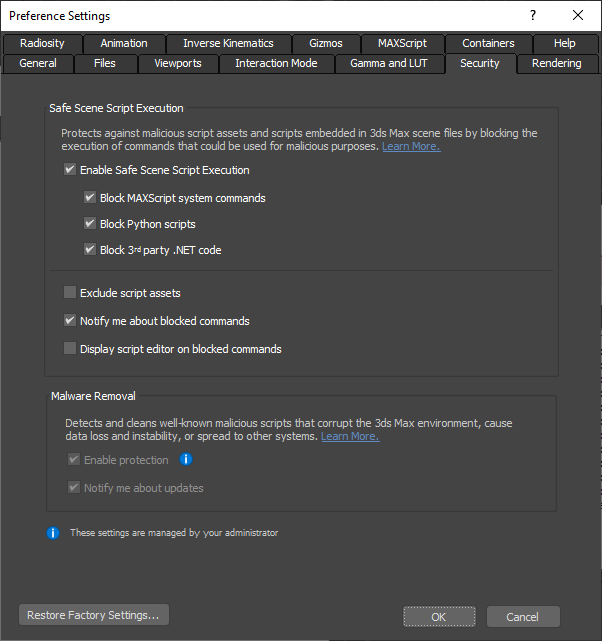

Starting in 3ds Max 2022.2 Update, system administrators can control the "Enable protection" and "Notify me about updates" settings for machines on their network, which prevents users from changing them. These settings are controlled via the following registry entries under [HKEY_LOCAL_MACHINE\SOFTWARE\Autodesk\3dsMax\24.0\Variables\MALWAREREMOVAL]:
Setting Registry Key Type Value Enable protection EnableMalwareRemoval dword 1=on, 0=off Notify me about updates DisplayUpdateNotification dword 1=on, 0=off System Administrator Note: This setting is not required, but it must be set to "*CADAdmin" to disable settings via the Preferences UI.
If it is not "*CADAdmin", or missing, the settings are only used if they are not present in 3dsmax.ini.
Owner string *CADAdmin When a setting is controlled via the registry, it is disabled on the Preferences dialog, and an icon indicates it is managed by a system administrator.
This example registry entry turns on all Malware Removal options:
[HKEY_LOCAL_MACHINE\SOFTWARE\Autodesk\3dsMax\24.0\Variables\MALWAREREMOVAL] "EnableMalwareRemoval"=dword:00000001 "DisplayUpdateNotification"=dword:00000001 "Owner"="*CADAdmin"
Malware Removal Locked by Administrator

- In 3ds Max 2022 and higher: See the "Enable Protection" option in the Malware Removal group in the Security tab of the Preferences dialog.

- In 3ds Max 2022 and higher: See the "Notify me about updates" option in the Malware Removal group in the Security tab of the Preferences dialog. When enabled, a notification appears in the Security Messages dialog when an update is available, with a link to the Autodesk App Store, where you can download the update.
