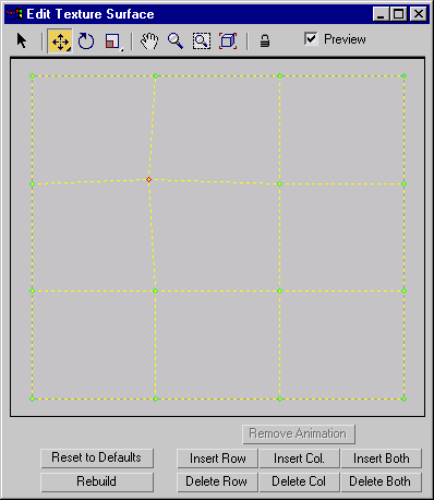

This dialog lets you edit the texture surface for a surface sub-object. It is available when you have chosen User Defined as the sub-object's texture surface method.
A texture surface is associated with the surface sub-object. The texture surface is used to control how materials are mapped. In effect, changing the texture surface stretches or otherwise changes the UV coordinates for the surface, altering the mapping.
The Edit Texture Surface dialog shows a 2D view of the texture surface. You can also edit user-defined texture surfaces directly in 3D viewports, using the Edit Texture Points button. See Material Properties Rollout.

- Preview
When on (the default), your edits are also shown in viewports. In viewports, selected texture points are displayed in red, and the others are displayed in green.
Texture Surface Image
Below the toolbar is a 2D image showing the points of the texture surface. You can edit the texture surface as you edit sub-objects in viewports.
If you right-click while in the image, the popup menu lets you switch between Select, Move, Rotate, and Scale. This is an alternative to using the toolbar.

Texture Surface Controls
The controls below the surface image edit the texture surface.
- Remove Animation
Removes animation controllers from the selected texture points.
- Reset to Defaults
Resets user-defined mapping to the default.
- Rebuild
Displays the Rebuild Texture Surface dialog, which rebuilds the texture surface and lets you change the number of CV rows or columns.
- Insert Row, Insert Col., Insert Both
Click one of these buttons to insert a row or column of points, or both at once, into the surface. Insertion adds points without moving other rows and columns.
While you refine the surface, the operation is previewed the same way Insert is previewed in 3D viewports.
- Delete Row, Delete Col., Delete Both
Click one of these buttons to delete a row or column of points, or both at once.
