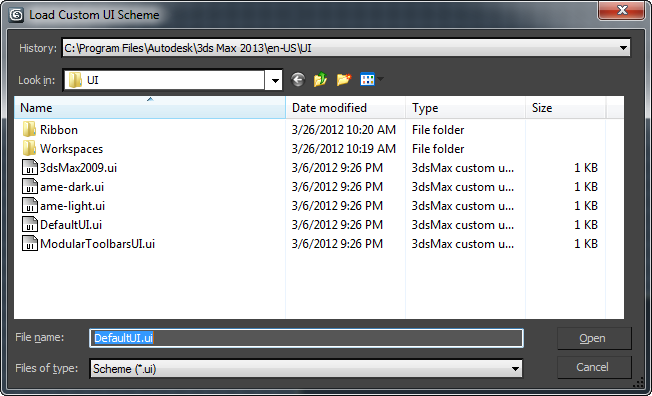

Use the Load Custom UI Scheme dialog to specify the base file name of the custom UI scheme to load.

Tip: You can resize the dialog by dragging an edge or a corner.
Use the Look In field to navigate to other directories. Click the folder to choose it. The files display in the window.
