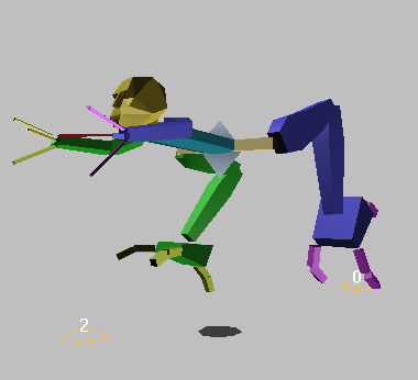

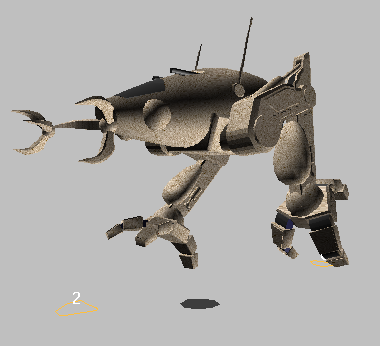

Jointed character linked with biped skeleton
Characters available commercially often come in two varieties: jointless and jointed. Jointless characters have a seamless mesh at limb joints. Jointless characters should be attached to the biped using Physique. A jointed character has separate objects with ball joint geometry for the limbs, and lends itself to the linking technique described in this topic.

To link a mechanical character to the biped (without Physique):
- Load or create a mechanical or jointed model. Body parts in this model should be separate 3ds Max objects.
- Create a biped.
- On the Biped rollout, turn on
(Figure Mode), then position and fit the biped to your mesh objects. - Go through the mesh objects and use
(Select And Link) to link each object to its corresponding part on the biped. All of keyframe animation applied to the biped will animate the model.
