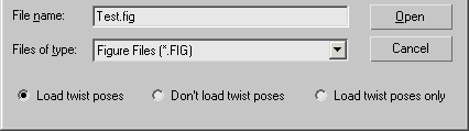

Clicking Load File brings the Open dialog, from which you can pick a FIG file and choose from the following twist poses options:
- Load Twist Poses: Loads both the twist links and twist poses data. (Default=on).
- Don't Load Twist Poses: Loads only the twist links data. Note: The pose presets are always available.
- Load Twist Poses Only: Loads only the twist poses data without the twist links. Note: The Twist and Bias values are not used without twist links. Refer to the Twist Poses rollout for details.

(Load File). - In the file dialog, choose the figure file to load.
- Choose one of the three loading options, depending on whether or not you want to load twist poses, or to load twist poses only.
- Click OK.
