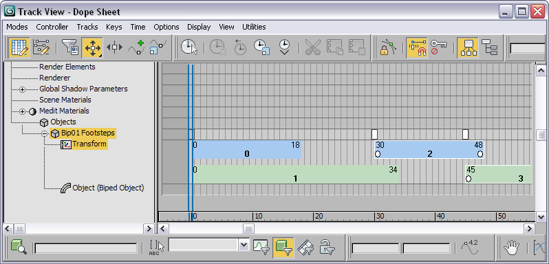

While the placement of footsteps appears in viewports, the timing appears in Track View - Dope Sheet Editor. There, each footstep appears as a block of time, with each block representing the time when the foot is planted in a footstep.
Footstep keys in Track View

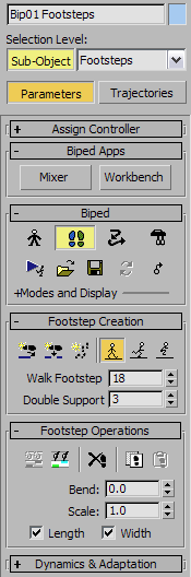

Select the biped and go to the
Motion panel.
- Click Biped rollout
(Footstep Mode).
- In the Footstep Creation rollout, click
(Walk),
(Run), or
(Jump) to choose the gait (a method or pattern of moving on foot). The gait sets the initial timing for footsteps you create.

- Create the footstep pattern in viewports. You can create footsteps in a few different ways, each available in the Footstep Creation rollout:
- Automatically create a number of footsteps with
(Create Multiple Footsteps), or
- Individually place each footstep with
(Create Footsteps (Append)) or
(Create Footsteps (At Current Frame)). Use Auto Grid to create footsteps on a surface of a mesh.

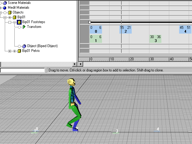

In the viewports, footsteps represent support periods in space for the biped feet. You can move and rotate footsteps in viewports. In Track View, each footstep appears as a block that represents a support period in time for each of the biped's feet. You can move footsteps in time in Track View. The footstep position and orientation in the viewport controls where the biped will step.

Within a footstep animation, there can be four foot states: move, touch, plant, and lift. These correspond to the state of the biped feet in relationship to the footsteps. Use the foot state displays in the Biped rollout to determine the state of the biped feet when you are editing the biped foot or leg keys. The foot states can be displayed in the viewport by turning on Leg states in the Display group of the expanded Biped rollout. The Foot states are represented as colored keys in Track View - Dope Sheet.

Footsteps displayed in Track View - Dope sheet editor
