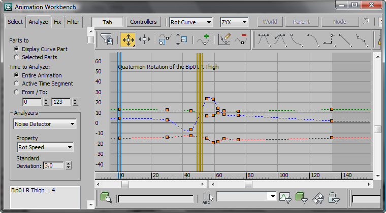

- On the Analyze panel, choose an analyzer from the drop-down list. Set the analysis conditions, then click Analyze. Any errors the analyzer encounters will be displayed in a list at the bottom of the Analyze panel. The Curve view also indicates the problem area by displaying a vertical bar.
- On the Fix panel, select the errors you want to fix. Select the filter for the fix, adjust its parameters, and then click Fix Selected. You can select the errors one at a time, or in any combination. You can sort the errors by time or body part, depending on what kind of fix is needed.
Errors displayed as yellow lines in Curve View
