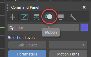

Found in the Command Panel, the Motion panel provides tools to adjust the motion of the selected object.
The Motion panel
  • Select an object. > Command panel > Motion panel
Key timing and easing in and out of a key are parameters that you can adjust with tools on the Motion panel, for example. The Motion panel also provides an alternative to Track View for assigning animation controllers.
