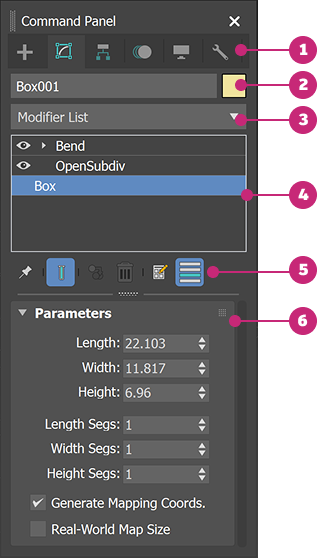

The Modify panel provides controls for editing object parameters as well as applying modifiers to objects and adjusting modifier settings. It also contains the modifier stack, a powerful tool for viewing and changing an object's edit history.
Modify panel (example)
1. Command panel tabs
2. Name and color fields
3. Modifier list (drop-down)
4. Modifier stack
5. Modifier stack tools
6. Parameters rollout
Use the Modify panel (General):
Select an object. - On the Command panel, click the
Modify tab to display the Modify panel. The name of the object appears at the top of the Modify panel, and the remainder of the panel displays settings for the object or the modifier at the top of its stack.
- You can now do any of the following:
- Change the parameters for the object. As you change these parameters, the object updates in the viewports.
- Apply a modifier to the object.
- View a list of the object's modifiers in the Modifier Stack display. You can change the active modifier (that is, the one whose settings appear on the Modify panel) by clicking it in the Modifier Stack display.
- Change the parameters for the active modifier. As you change these parameters, the object updates in the viewports.
- Collapse the stack to create an editable surface such as an editable poly.
