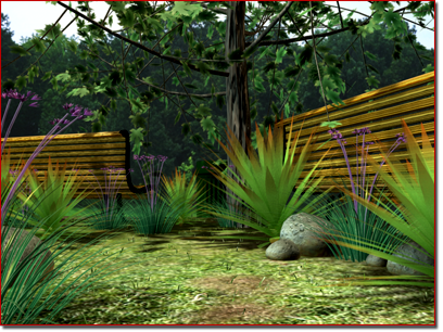

Representing Natural Materials
Outdoor scene with natural materials
Most natural materials have a matte surface with little or no specular color. For natural materials such as these, use the following guidelines:
- Ambient color: The ambient color depends on whether the scene is indoors or outdoors, as previously described.
- Diffuse color: Choose a color found in nature. It is best to use the observed color of the object itself, or a similar object.
- Specular color: Make the specular color the same hue as the diffuse, but with a higher value and a lower saturation.
- Glossiness: Set the Glossiness to a low value.
Some foliage, bird feathers, fish scales, and so on, are shiny. For materials such as these, set the Glossiness to higher values. You might also want to change the specular color so it's closer to the lighting color than the surface's diffuse color.

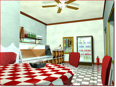

Representing Manufactured Materials
Indoor scene with manufactured materials
Manufactured materials often have a synthetic color rather than an "earth tone." Also, many manufactured materials, such as plastics and porcelain glazes, are very shiny. For manufactured materials, use the following guidelines:
- Diffuse color: Although the diffuse color doesn't have to be an "earth tone," as with natural materials you should used the observed color of the object or a similar object.
- Specular color: Make the specular color close to white, or to the color of the light source. White is especially characteristic of plastic materials.
- Glossiness: Set the glossiness to a high value.

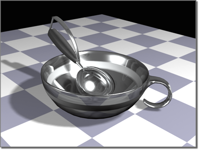

Representing Metallic Objects
Metallic cup and ice cream scoop
Polished metal has a characteristic "glancing" highlight that appears where the light is at a high angle of incidence. To generate this effect, Metal shading uses the Cook/Torrance illumination model.
For metallic materials, you can use the Metal shading type. This disables the specular color and highlight controls. The Metal shader calculates its own specular color, which can vary between the diffuse color and the color of the light.
In the diffuse region of a metal material, the ambient component is greater than it is for other kinds of materials.
The Anisotropic, Multi-Layer, and Strauss shaders give you further options for modeling polished metal.
If the metallic object is the focus of the scene, you can improve realism by using a Blend material to combine metallic shading with a reflection map.
