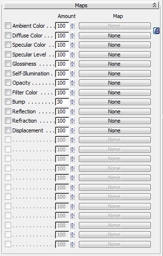

A material's Maps rollout lets you access and assign maps to various components of the material. It also lets you set an Amount value (relative strength) for each map.

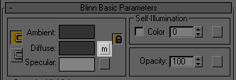

    In the Basic Parameters rollout, if a map has been assigned to a color component or parameter, the corresponding button displays a letter M. In the Maps rollout, if a map has been assigned, the corresponding button displays the map name.

  • On the Maps rollout, turn off the map's checkbox.
    The checkbox is to the left of the map's name.
    When a map is off, a lowercase m appears on the corresponding map button.
To turn a map on:
  • In the Maps rollout, turn on the map's checkbox.
    When a map is on, an uppercase M appears on the corresponding map button.
To change a map's strength:
  • In the Maps rollout, adjust the map's Amount spinner.

This rollout lets you assign a map or shader to many of the Standard material parameters. You can also assign maps and shaders on the rollout where the parameter first appears: The principal value of this rollout is that it also lets you toggle a parameter's shader, using the checkbox, without removing the map.
The Amount spinner determines the amount that the map affects the material expressed as a percentage of full intensity. For example, a diffuse map at 100% is completely opaque and covers the base material. At 50%, it is semi-transparent and the base material (the diffuse, ambient, and other colors of the material without maps) shows through.
Note: The Maps rollout can have unused, disabled control rows. This is because the number of components that can be mapped varies depending on the current shader. The last four enabled rows are always Bump, Reflection, Refraction, and Displacement, in that order.
