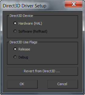

When using the Legacy Direct3D display driver with 3ds Max, this dialog lets you make some basic choices for setting up the driver. Further Legacy Direct3D configuration options are available from the Configure Direct3D dialog.

Direct3D Device
The default option is Hardware (HAL). The Software (RefRast) option is for use by software developers, and is unavailable unless the debug version of DirectX is installed in your system.
Direct3D Use Flags
The default option is Release. The Debug option is for use by software developers, and is unavailable unless the debug version of DirectX is installed in your system.
Revert from Direct3D
Click to return to the Display Driver Selection dialog, which lets you choose a different driver.
