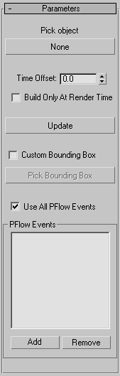

Parameters rollout
- Pick Object
Click this button and then select the object to be instanced by the Mesher object. After doing so, the name of the instanced object appears on the button.
- Time Offset
The number of frames ahead of or behind the original particle system that the Mesher's particle system will run. Default=0.
- Build Only At Render Time
When on, the Mesher results do not appear in the viewports, but only when you render the scene. Default=off.
Use this option to reduce the amount of computation required for the viewport display.
- Update
After editing the original particle system settings or changing the Mesher Time Offset setting, click this button to see the changes in the Mesher system.
- Custom Bounding Box
When on, Mesher replaces the dynamic bounding box derived from the particle system and modifier with a static bounding box of the user's choice.
- Pick Bounding Box
To specify a custom bounding box object, click this button and then select the object.
The custom bounding box appears as an orange wireframe when the modifier is highlighted in the stack.
Tip: You can use any object as a bounding box, so it is often fastest to use the particle system itself. Move to the frame where the particle system is the size you want and pick it. - (coordinate values)
Displays the coordinates of the opposite corners of the custom bounding box.
- Use All PFlow Events
When on, and you've applied Mesher to a Particle Flow system, Mesher automatically creates mesh objects for every event in the system.
To use only certain events, turn this off and specify the events to use with the PFlow Events group controls (see following).
PFlow Events group
When the Mesher object is applied to a Particle Flow system, use these controls to create meshes for specific events in the system. Mesher does not create meshes for the remaining events.
- [list box]
Displays all Particle Flow events currently affected by Mesher.
- Add
Lets you specify Particle Flow events to be affected by Mesher.
If the Mesher object is applied to a Particle Flow system, when you click Add, an Add PF Events dialog opens listing all events in the system. Highlight the events to add, and then click OK. The events now appear in the list.
- Remove
Deletes highlighted events from the list.
