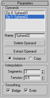

Parameters rollout
Operands group
[list of operands]
Displays the current operands. Select an operand to rename, delete or extract by clicking it in this list.
Name
Renames a selected operand. Type in a new name, and then press Tab or Enter.
Delete Operand
Deletes a selected operand from the list.
Extract Operand
Extracts a copy or an instance of the selected operand. Choose an operand in the list to enable this button.
Note: This button is available only in the Modify panel. You can't extract an operand while in the Create panel.
Instance/Copy
Lets you specify how the operand is extracted: as either an instance or a copy.
Interpolation group
Segments
Sets the number of segments in the connecting bridge.
Tension
Controls the curvature in the connecting bridge. A value of 0 provides no curvature, while higher values create curves that attempt to more smoothly match the surface normals on either end of the connecting bridge. This spinner has no apparent effect when Segments is set to 0.
Smoothing group
Bridge
Applies smoothing between the faces in the connecting bridge.
Ends
Applies smoothing between the faces that border the old and new surfaces of the connecting bridge and the original objects. When turned off, 3ds Max assigns a new material ID number to the bridge. The new number is one higher than the highest ID number assigned to either of the original objects. When on, the ID number is taken from one of the original objects.
Note: If both Bridge and Ends are on, but the original objects contain no smoothing groups, then smoothing is assigned to the bridge and to the faces bordering the bridge.
