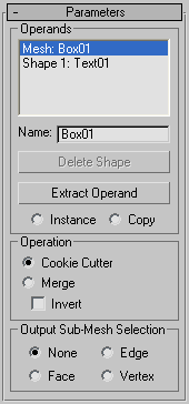

Parameters rollout
Operands group
[list of operands]
Lists all operands in the compound object. The first operand is the mesh object, and any number of shape-based operands can follow.
Name
If you select an object in the list, its name is displayed here. You can edit the field to change the object name.
Delete Shape
Remove selected shapes from the compound object.
Extract Operand
Extracts a copy or an instance of the selected operand. Choose an operand in the list window to enable this button.
Instance/Copy
Lets you specify how the operand is extracted. It can be extracted either as an instance or a copy.
Operation group
These options determine how the shape is applied to the mesh.
Cookie Cutter
Cuts the shape out of the mesh object's surface.
Merge
Merges the shape with the surface of the mesh object.
Invert
Reverses the effect of Cookie Cutter or Merge. With the Cookie Cutter option, the effect is obvious. When Invert is off, the shape is a hole in the mesh object. When Invert is on, the shape is solid and the mesh is missing. When you're using Merge, Invert reverses the sub-object mesh selection. As an example, if you merge a circle shape and apply a Face Extrude, the circular area is extruded when Invert is off, and all but the circular area is extruded when Invert is on.
Output Sub-Mesh Selection group
Provides options that let you specify what selection level is passed up the Stack. The ShapeMerge object stores all selection levels; that is, it stores the vertices, faces, and edges of the merged shape with the object. (If you apply a Mesh Select modifier and go to the various sub-object levels, you'll see that the merged shape is selected.) Thus, if you follow the ShapeMerge with a modifier that acts on a specific level, such as Face Extrude, that modifier will work properly.
If you apply a modifier that can work on any selection level, such as Volume Select or XForm, the options will specify which selection level is passed to that modifier. Although you can use a Mesh Select modifier to specify a selection level, the Mesh Select modifier considers the selection only at frame 0. If you've animated the shape operand, that animation will be passed up the Stack for all frames only by using the Output Sub-Mesh Selection options.
  • None Outputs the full object.
  • Face Outputs the faces within the merged shape.
  • Edge Outputs the edge of the merged shape.
  • Vertex Outputs the vertices defined by the spline of the shape.
